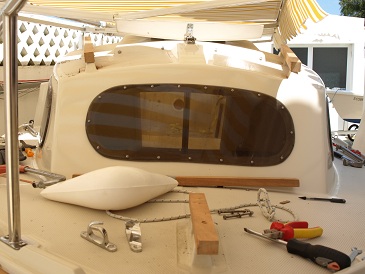

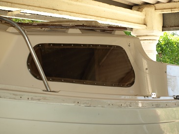

1) Outside & Inside: the wood work around was missing, the rest was to old to stay there. The hull and cabin are all in original GelCoat, some scratches, very few cracks, very nice. I saw, that at some point this boat was well serviced, and they polished everything. The keel was with some rust, not to deep. The bottom paint was old, I sanded of as much, and decided to seal the bottom with 4 layers of International GelShield, and then aplly International Bottomcoat. I must say, i'm a Trailer Sailor and this Cabochard will not be sitting in the water, but will be kept home. Inside the hull, where you can inspected it from the the middle storage box, evrything looks really good, dry, no repairs, no signs of osmose whatsoever. This storage box has also a removable cover to the cabin, screwed, but can be open. I have some ideias about that, how to use the space under the stern floor... maybe! :-) The cabin was also in good shape, all furnished with carpet, walls and ceiling, not to dirty, no smells! One little sweet smell disapeared when I took an old gas thanks tube out! ;-)
2) Sails and Rigging: I expected the sails to be rotten or ruined, they were not. Actually they are original, as one of us here explained me. They have the black "thunder" mark. All the mast, boom and steel cables are also original, and inspite they show some age, they fit perfectly and are in good shape to use. Only one cable was cut, and I took it to a shop and had a proper press ring type emend (a normal cable end) and then sealed with rubber around so the sails don't get cought on it.
3) Engine: I could have had a 9.9hp from the previous owner but... I think it was too old to be worth the maintenace and repair, he was from the end 80's or so. Also I knew that engine came from a fishing boat, which means he was problably tired... I'm using my previous Yamaha 4hp 4 stroke, one year old. It could be bigger, but on my first trials it moved the boat fine, and to dock as well. It is a Short Shaft, so I installed a inox Engine Bracket. This way he gets in and out of the water with a smooth push, and also gets totally away from the rudder, which is good to. You can steer with the rudder if you keep the Engine on a fixed position, for instance.

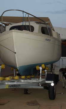

4) Trailer: the trailer was Portuguese Made, good I should say, but with a 300Kg Gross Weight - problably to escape a register as a vehícule. I swap it with my newer trailer which can carry a Gross Weight of 450Kg - yes, it is registered! ;-) By the way my trailer uses Rollers so the boat slides, the other one is a "sit on" type... for a trailer sailor, I think it's not that good.

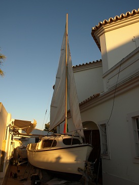

Second Stage!

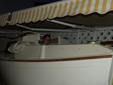

Bringing her from Lisbon, to the Algarve, aproximately 300Km. No problems, all fine, 3 hours more or less.
Then the trading of Trailers begun after arriving... First I put my open boat on the floor, to vacancy his trailer, very gently, on ruggs, and decided to make the Cabochard roll from his trailer directly to mine with the winch. It worked fine! First I took the bow pole out, then made the original trailer slide and fit under the new one as far as I could, then... I winch it! ;-)
This way the Cab always had rollers under so it would not fall to the sides.
And the night was falling, and the final result was pictured the day after.

And the REAL works begin!
Woods, varnish with dark brown, GelCoat repairs (with GelCoat I must say: sand, gel, sand 600, sand 1000, sand 1200, polish), bottom seal, bottom paint, check sails, check rigging, check all abs and inox parts - the bow inox piece was missing! I replaced with new ones but would VERY much like to have a ORIGINAL one... anybody can help?
All done slowly from June to now (1st Sept), but still are a few things to done. She is ready to water anyway! ;-)

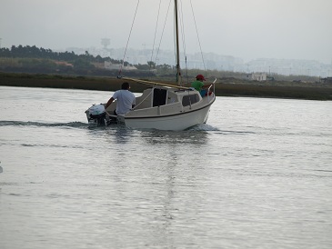

Well, on the 31st August 2011, there we were at Ilha de Faro (Faro, Algarve, Portugal) for Engine inspection of Bravura, and I still made some trials of how deep the engine would be in the water, or angle. This photos are testing all that, but was not complete... I first need the register documents to be really able to go out in the water and to real engine tests, sail, and... sail hard! ;-)
Hugo

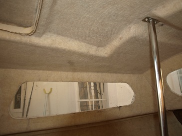

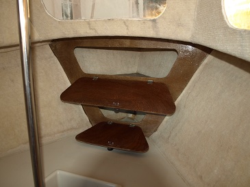

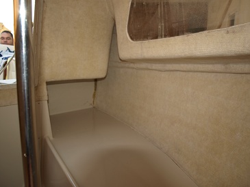

Some inside cabin photos.
I just kleened it, and made a light wood floor (maritime 9mm plywood) to save the original one from weight of passengers, and better distribution of weight on the original floor structure.
Hugo

par contre, la photo d007 m'étonne, jamais vu l'arrière aussi enfoncé dans l'eau !

Thoro: I understood you were saying the stern was too much in the water? I think it is not the sailor's weight! Should be the Engine, gas, or others ballasts... :D
